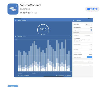

Also are you using the VictronConnect app? This might open up a lot of monitoring and control capability. It depends on what other Victron equipment you have. Is there any documentation in your manuals case for a Victron Cerbo GX? If so that’s where you’ll find info on controlling the display. If it we me facing this, I’d tap that Victron logo and see what happens, but you’ve probably already done that.
