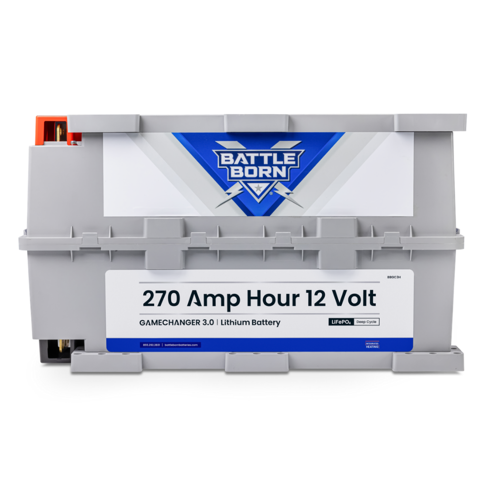

Battleborn called me today while on my drive to the next stop, was nice chatting with them and getting details pinned down. They now have a heated GC3, it's a little more money but solves the problem of cold weather camping. Still needs an enclosure as it's not going to heat enough for an outdoor/exposed battery. But something I'd probably consider.

I'm discovering that you shouldn't dive in to LifePO4 so fast. There are so many competitors on the market now including the option of building your own. A YouTube video popped up today educating me on SOK LifePO4 batteries such as the one below which is half the cost of battleborn.
