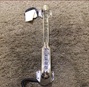

We have found that trying to unlock the entrance door to the DutchStar using the electronic keypad can be challenging.
Enter the code and hold the top button for 5 sec sometimes works and other times it doesn’t.
Any thoughts on proper operation of this locking bar?

I used the key fob for many months because I bought mine used and didn't get around to digging out the codes the previous owner game me (and we weren't traveling much) and it worked. Once I found the codes, I have used that keypad and mine has worked. I think I hold down for 3 seconds but it's in the neighborhood of what you do. If your porter struggles, maybe give him the key fob to use.

You can try power cycling the trimark controller which is typically behind the dash, a white box. Lift the cover behind the dash gauges to access. Yours may be defective and should be on your warranty list.
Yes, they changed how this works in newer coaches vs. my 2017. 1, 2, and 4 work on my keypad, I think they removed option 4 in newer coaches which unlock door and baggage compartments? Or maybe it was option 2?
I enter the 5 digit code then hold the # 1 button 5 sec to lock the door, when i unlock it enter the 5 digits ,then only push the # 1 and not hold to unlock
2 locks and unlocks my compartment doors
I just remembered that my entry door wouldn't look with keypad but my compartments did. I cleaned the brass sensors on the door frame for better contact and that solved the problem.
