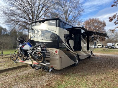

In regards to motorcycle lifts here is a link that may help. It has a variety of options. I personally have a Hydralift on my Class A and love it. My lift is welded directly to the frame not the hitch so hitch limitations may not be an issue. Since the lift sits so far behind the rear wheels there is a formula to calculate the weight. I will try to find it.

Here is one of the discussions with the formula for weight.
