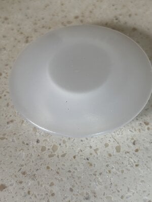

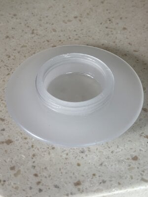

Changed out 3 original lights that were flickering. The Amazon lights are slightly brighter when lit, and the glass (plastic?) cover is not exactly the same as the original. But all in all, they're so close that nobody will ever notice.
Also, when their not lit, the plastic cover is a bit darker than the originals. But again, they're so close that nobody would ever notice. Pretty easy to swap.
Picture 1
Slight difference in cover design. But it's hardly noticeable when the lights are installed.
Installed with some water resistant doohickeys that I generally use when splicing phone line cable.

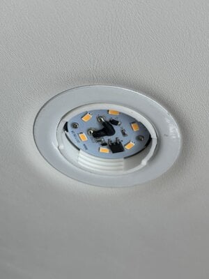

The light on the right is the Amazon replacement. Slightly brighter but hardly noticeable. The longer you stair at it, the blinder you get, and in about 15 seconds they look just fine. :)
Another picture of the brighter light. The stock light is on the left of the vent, the Amazon replacement is on the right side of the vent.
