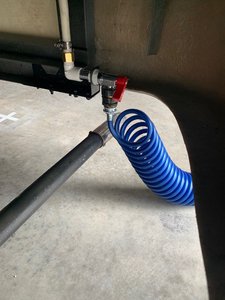

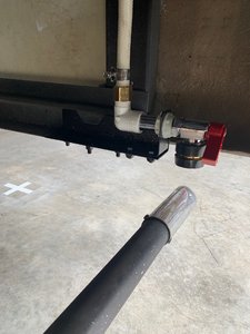

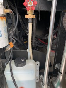

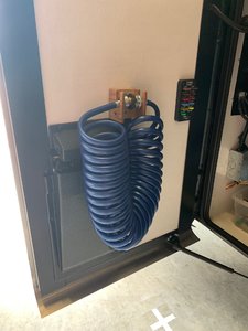

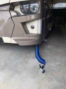

As @lostinfla posted, I replaced the wet bay shower with the same faucets. For the black tank rinse I wanted to use the water source before it entered the house filters.
The hookup has another back flo attachment, the the coach has its own back flo and air gap unit already in place and the rinse hose is never left attached to the clean out so I’m satisfied that this safer than if I were running a separate hose to the water source each time I back flushed with the park water source.

As @lostinfla posted, I replaced the wet bay shower with the same faucets. For the black tank rinse I wanted to use the water source before it entered the house filters. View attachment 744View attachment 745
Sure like how you have the filters installed. I want to do that to mine too. Also looks like you cut the back plastic panel in half. That is perfect so you can remove and inspect or get behind the panel without as much trouble as the one piece backing.
Actually, the right half of the bay panel is a 1/4” plastic sheet that I cut to size and mounted over the original panel. The factory panel is so flimsy that I was afraid of mounting the double filter and towel holder on it. I did the same with the right sidewall where the pressure regulator is mounted. Much, much sturdier now.
