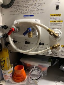

@MapNerd @Neal … just a question. Before you disconnect the hose, do you first drain the system using this valve?? It dumps under the coach.
My coach doesn't have that valve
Our 2018 MADP also has that drain valve and it works as described. I think the actual purpose is to drain the tank rinse system for winterizing. I also carry a round, rubber pan in the wet bay (check farm supply stores for them) to put under the connection to collect stray water.
I open valve @FLSteve suggest, will get most of the water out but still will dribble a small amount
@FLSteve that is one nice setup. Where did you get those faucets for the wetbay shower? Another mod to add to the list.
