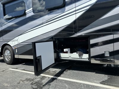

On a DS where is the valve to turn on front water spigot by generator?
Joe, on mine, it’s in the second pass-thru bay on the driver’s side along the frame rail. It’s a quarter turn valve.
Follow the water line back, you will find it.
There are two. One is near the spigot, just aft I believe (or it's the drain line below the spigot), and then as others are pointing out it's on the frame rail just forward of the oasis most likely.

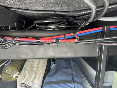

As suggested, follow the line back.
Found it
