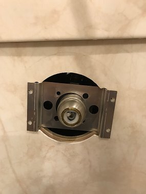

I got the Gabrylly replacement kit. I didn’t need all the parts, just the valve and I changed out the shower head. The item number was NB6206BN and I got it on Amazon. It was fairly easy to replace and the cartridge is ceramic and not plastic like the last one.If the piping is thumping against the shower wall the only solution is to dig back in there and try to secure it better. I still haven’t done this improvement yet; what valve make/model did you use, and are you satisfied with it?
Are you sure about that? I'd think that's a one way output for tub fill.The nice thing about this one is that it has a tub filler outlet that I could use to return cold water to the fresh tank while waiting for hot water,
it is but why couldn’t that be connected to a new line plumbed to return to the fresh tank? Just like filling a tub. Somewhat mute anyway because I’ve decided its not worth the trouble and I’ll just cap it. I’ve been re-reading that other thread - interesting stuff, especially the seven stitches!Are you sure about that? I'd think that's a one way output for tub fill.
