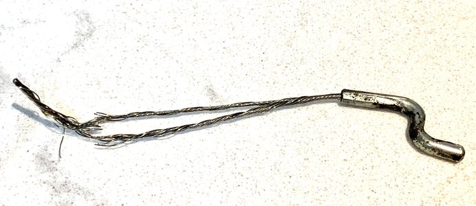

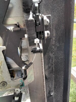

Yesterday I decided to take care of the wet bay door latch misalignment, and check overall the latch mechanism? Lucky I did.
The short braided wire piece of stainless steel wire that pulls down the latch trigger, was holding by two strands. All the rest were broken.
From the two 1/4x20 nuts holding the latch together, one was loose and ready to fall off.
If any of the two had failed, I could have been stranded somewhere with full waste tanks, and no way to do anything about it for a while.
Hope Newmar sells just the stranded wire part?
