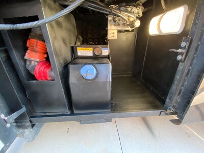

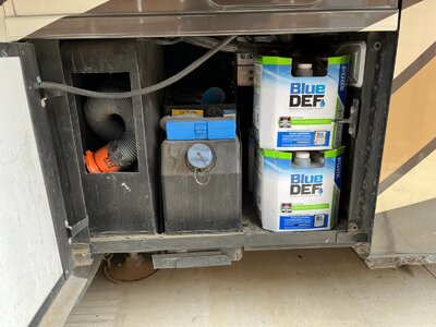

I usually buy my DEF at the pump when filling with fuel just for the convenience of not having to deal with jugs and overfilling. On our last trip, our first stop was near Ocala Fl, so I stopped before the campground to fill up. (I make it a habit to arrive at a campsite with a close to full tank). Stopped at a Loves, got fuel and DEF. While filling the DEF tank, it smelled much like an overfilled cat litter box, but I didn't think much about it. A short time after, the check engine light came on (just orange outline) with code SPN 3216/FMI 2 which translates to "Difference between the expected NOx ppm and the actual NOx ppm is greater than 200 ppm." I ended up syphoning all out of the tank and refilling with Blue Platinum from Walmart. I'm sure if we had a newer coach with the "improved" DEF head, we would have been dead in the water at that point. After running to our next camp (about 250 miles) the light went out with no ill effects. Don't assume the stuff coming out of the pump is fresh. I will NEVER buy DEF at the pump again and I'll check the date codes on the jug to make sure it's fresh.
