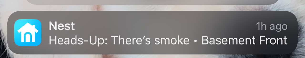

Hanging out in Charleston, SC awaiting my move into Hilton Head Island Motorcoach on Tuesday I figured I'd enjoy a lazy Saturday. Laying in bed watching TV amazed at how nice OTA TV channels are and all of the sudden my NEST smoke detector above my bed turns yellow and announces "Alert - smoke in the basement. Alarm will sound soon and will be loud." I go flying out the door as did the dog, I yelled "lunch cookie" to auto retrieve dog, she came back running into the coach and I gave her a quick cookie then launched back out the door. I started opening all basement doors to ventilate as I didn't want the alarm to go off. I smelled something burning, electrical I assumed and started looking. I didn't see smoke. I checked the inverter, battery bay, shore power area, all looked good so I figured it was the same ole same ole OASIS! Verified inside by it not working with AC I / II ON. No breakers were tripped which is surprising.

As to the NEST smoke detectors, which were installed as a result of OASIS shorts in the past, I have to say how happy I am with having installed them. I replaced both inside with NEST detectors and added two in the basement, one over the inverter, one over the shore power reel which picks up the smoke from the neighboring OASIS system as it did today. Great alert, very clear and got me moving immediately for action.
