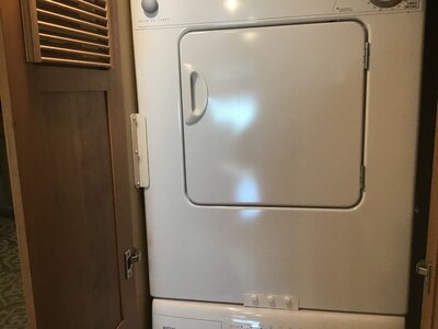

When Newmar paid to have my local service guy replace my Whirlpool, It took 2 men less than an hour. You have to remove the doors to the laundry compartment, remove the top door holding mechanism so the door can swing completely open. The machine will easily go out the entrance door. It will need to be lifted over the co-pilot seat. I hope this helps.

Yep, I'm going to remove all that and be prepped to save their time. I just did all that when I removed the units myself into the bathroom to get into my washer to check for problems. So again, I think the $140 is well spent for the labor, I just have to decide if I want to replace the two units and with what, Whirlpool recent or Splendide. Just trying to figure out if I want to take a swing at selling this coach after my Newmar visit which will be "newed up" again with a new windshield, new upholstery, new carpet. Not sure what I could realistically get for the coach, that's for another topic, with all the mods, some of which are major. Just want to capitalize on the sellers market if the opportunity presents itself but I'd probably have to wait 1-2 years to re-enter the RV market.

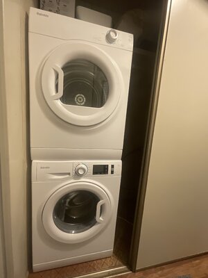

Well I am done. It was not as bad as I thought it would be, just a little cramped in the bathroom with the toilet being right in front of the washer and dryer. I removed the cabinet doors, the screws holding the feet of the washer and the piece of wood on top of the dryer. Then pulled the units out about half way and removed the plates on both side that held the 2 units together. Then took out the dryer ( they could have made the vent hose about 8" longer and that would have made it a lot easier to remove and reinstall) Then 2 of us were able to lift the washer up and out of the cabinet over top of the toilet and carried it out the front door. I did not have to do anything to the front door, it fit with a inch or so of space. Put the new Splendid machine in, hooked everything up and I am done. The Splendid is about 3/4" narrower than the Whirlpool so the dryer hangs over a bit on one side but no big deal.
