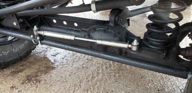

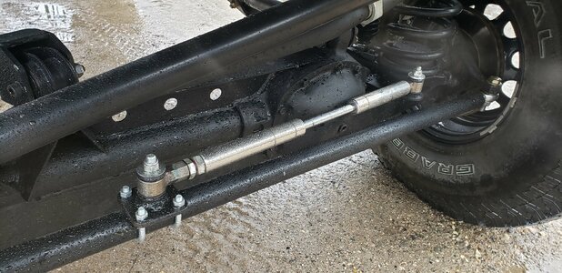

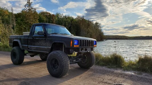

My grandson just gave me pictures of his 1988 Comanche with 12" lift 35 x 12.5 tires and this does have a 125 lb Exact Center, he drives 85mph on the interstate and says it drives like an SUV. He is 26 so keep that in mind. He says it is very good and it was very very bad before the installation of EC. The EC used was an early prototype and not the current single shaft tandem.

His setup looks very similar to how I modified mine. You can see I have relocated mine above the Tie Rod, but below my trackbar. Out of frame is my drag link, which is now mounted higher, so that it is inline better.
By using that adjustment on the tie rod, I should be able to accommodate any size / length necessary.
As long as it fits in the bracket on the left, I should be good to go. Just need to get a higher PSI for my large tires.

Is that a stock JL stabilizer now. If it is the ends should work with EC. Roadmaster will make sure you are happy in the end. They do have a limited life time guarantee on everything they sell. They probably have 50000 products so that is saying a lot.
