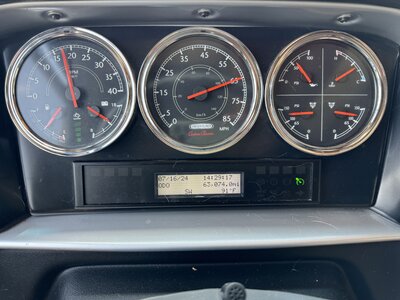

This is a beautiful sight (no lights):

After the regen was where the gold is and why this tool is a must have! It clears the codes. If you can't clear the codes then you're not going anywhere. But first I used the scan tool to READ the codes and the nice thing is instead of those SPN numbers it actually tells you in plain English (images attached) of the problem. So I then cleared the codes but my engine outline didn't go away, hmmm, why not? So I then did two engine on/off cycles, one minute in between, and it went out. I sped out of there, got on the Interstate, and no derate and no further issue (so far) and made it to the campground.
