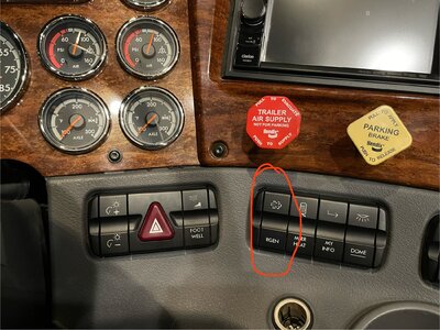

Yes, I know truckers idle for long periods of time. Also know that most of these same truckers have a switch (like below pic) on their dashboard to start a regen, no special tool required. So accumulating some extra soot in the DPF is not a big deal.
I’ve often thought about replacing my shorting plug with a switch on the dash (very simple job and there is room for an additional rocker switch). but I have never had the need to do a parked regen because I do forced regens proactively. Still it bugs me that every other type of vehicle with a HD diesel engine has the convenience of a regen switch, and for whatever reason, motor homes don’t.
Well, the switch is on the Superstar - standard on the M2 chassis.
Can stop one in progress if needed as well as start one when the yellow light is on stating a regen is needed.
Does not do a parked one from the dash though unless the yellow light on that a regen is needed.
All as it should be. Maybe when I get everything else done on my coach list I’ll install a regen switch. Is yours spring loaded/momentary of just on/off?
I thought in 2024 Cummins / engine manufacturers were required to offer the ability to regen, etc. @redbaron I think you mentioned something about this some time ago?
The switch on our rig is a spring loaded momentary switch - and it has to be held for 5 or 10 seconds. Regen will not start instantly.
