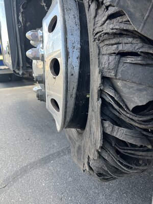

At this point still no idea what happened to the steer tire, there is no tread anywhere on the remains just torn out and frayed belts. Both sidewalls are intact and remained on the rim, I suppose due to the Tyron device holding them in place. I have found no blowout pics or videos that duplicate the look of the tire online anywhere as of this time. Am leaning on replacing the Tyron with the Retrobands but not decided yet. Will be hardening/armoring the electrical bay like I did with the rear tire wheel wells later this fall after we get back to Florida. 20/20 hindsight but all I can do now.

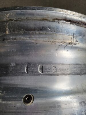

Update - sorry, thought I had added these pics to original post and I have referred to them a few times. First one shows the Tyron slippage on the blown out tire I have mentioned a few times in this and other threads regarding Retroband and Tyron. Second one was taken by tire shop, is the right side (non blowout steer wheel) after removing the Tyron to change tires. Tire shop that FL has replacing my tires says it is damaged by the Tyron install and requires replacement. Not knowing anything about damaged wheels, or having anything to compare to but this and the slippage to me point to a bad Tyron install so far in my book as to what actually happened. Why my tire shredded so badly is still not clear, could be due to the bad install, or not. Mine looks nothing like any example of blown tires with Tyron on their website. Factory tires were 0118 date codes so they were 2 years old before leaving the factory in April of 2020 to head to dealer so there is that. So far no reply from Tyron_USA to any of my attempts to reach them. Was notified an hour ago that RV is ready to move from FL to a body shop still being determined. Total for the electrical repairs was roughly 5K, with another 1k ish for both front wheels, and approx 4500 for new tires all the way around before any body work gets done. I also need to armor up the electronic bay after the fact to hopefully avoid any damage like this in the future. Still not clear what actually happened, but not ready to throw in the towel, and am hoping the body shop can get me back on the road before Thanksgiving. I do plan to get into NIRVC for Retrobands as I dont want to attempt a blowout on a rim again at any speed. No confidence in the Tyrons after this event.

Can you please also clarify what rig you have. Your profile shows you have a 2009 King Aire, but you've made a couple reference about the tires being "factory...build".
And, do I see a Tyron Band around that rim?

Those pics are the 2020 Kountry Star 4037 that I had the most recent blowout issue with as detailed in this thread. We have decided to move on from that coach and now have the older 2009 KA in my signature and the 2020 is still being repaired. It will be consigned away if i ever get it out of the body shop. Yes, that is a Tyron, that was not installed correctly and "slipped". It's right hand side counterpart was also not installed correctly and while it didn't blow it required I replace the right side wheel as well as the left that made contact with the pavement when the tire shredded.
Thanks for the info, Scott. Forgive my redundant question; I have NO idea why I only saw the "first couple" posts by you...my fault.
I now see you DID have Tyrons. I asked, because I have read elsewhere of faulty installs. Really sorry that you had to find out the hard way that you were one of them.
