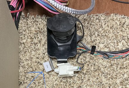

Is this just a Freightliner procedure ... or does/will it work on Spartan as well?
FLSteve
FLSteve
I would expect differences since the emissions system controls on a Spartan chassis are different. But check under the dash next to the j1939 port and see if you have that plug. I found the diagram a little vague but the acutal plug is labeled and obvious (see pic). If you have that then the process should be the same. 062877C8-0038-44FD-AA8C-F927031E562C.jpeg

Actually it's not the same for FL coaches, mine is older and has the shorting connector, newer ones I believe are done differently and possibly via the dash. @Tnedator has Spartan.
