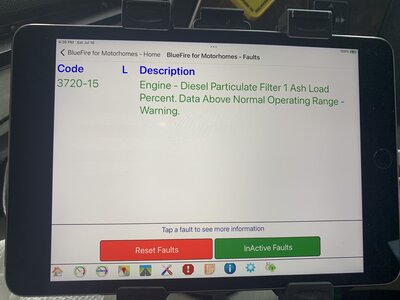

I am arriving at Spartan in Charlotte, MI today and will discuss things more with them. I have a check engine light with key on which will go out after about 20-30 seconds. I have driven approximately 4000 miles this way as it is considered an inactive message from a previous incident and will be reset by Spartan.
Additional note, I run BlueFire which will clear some active faults but not inactive faults.

Here is the message which is inactive, it was caused by a active regen that was unable to complete because of extended road construction and low speed. I have since had probably 5-6 regen’s that completed normally. I agree that having a device that allows owners to do forced regen is very valuable A97D158B-A507-46D7-AB31-078C324DF73C.jpegto
