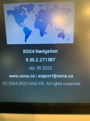

@ARD ... here is the version I have. At least this is what shows up. Any progress on your end?
FLSteve
