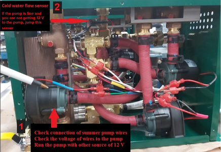

My Oasis is giving me intermittent problems with the hot water supply. It is good for one or two days or even a few hours and then no hot water. There are no fault lights on the unit or on the control module. When I toggle the switch on top of the CM, I don't hear the summer loop pump come on but for whatever reason, I start getting hot water. I have spare pumps but I'm not sure that's the problem. I called ITR twice this week and left a message with no callback. Any advice?
