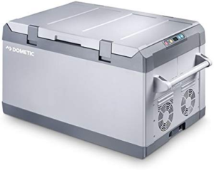

I admittedly got jealous of @ARD cooler in her front basement compartment of her DSDP 4369 and as my freezer is packed to the brim on my long trip I decided to look into getting one myself. With some reorganization and adding shelves in my 4037 I realized I could make this happen and with Alaska in my future and hoping to fill it with Salmon etc. I looked into getting one. I contacted Newmar Parts first and they quoted approximately $2400 for the Dometic CF 80 and $1200 for the slide out tray system. I researched and found the cooler on Amazon for much less at approximately $1089 and per @TJ&LadyDi leading me to Keystone as the maker of the slide out they quoted me around $650 (including over $100 of that in shipping). So huge savings.

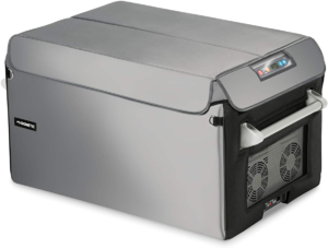

I got the cooler and have been amazed with it, very pleased with the purchase and right now just using it for wine, beer, and sodas. Now I'm going to start building out shelves, one to go above it and also some above the chassis rail storage in other areas of the basement. There is a lot of lost storage space by unused areas above the bottom of the chassis rails. I bought 1/2 inch MDF I'm going to use and I have the basement carpet I got from Newmar last Winter as I've always wanted to put in the shelves. Share your shelving mods and how you went about it as I'm going to be doing this as soon as my slide out arrives from Keystone. I also bought the insulated cover for it to help save some energy and insulate in very hot basements during the summer.
Dometic also has dual zone coolers so you can have frig and freezer in one but the reviews were concerning so I went with what Newmar chose to be safe. It seems people have been very pleased with this.

Neal, the Dometic that came in our MADP can be used as either a cooler or freezer. I don't remember the model # at the moment and it is too dark to go out and look right now. Are you saying that Dometic has a model that has two zones within the same unit; i.e freezer on one side and cooler on the other? If yes, it seems like the two compartments would be pretty small.
TJ
TJ,
I got the one Newmar uses which is the CF-80 which as you say gives you the either or option. Dometic has many other coolers and the new CFX has two compartments so you can have one compartment as a freezer and the other frig or use both the same, etc. Reviews didn't look good on Amazon with frequent failures so I didn't go with it but stayed with what you got from Newmar, the CF 80.

P.S. The cooler handles will come off when it goes on to the slide out tray. Just four allen screws per handle (2 ea side). Also I'm surprised Newmar doesn't reverse the lids on these which you can do and I did so that the plug is aft as that's where the electrical comes from. They seem to run a 120V all the way around the compartment to the front doorside edge. The outlet I added on the between basement bay 1 & 2 roof area seems to be working well for this setup. I will likely aft align the cooler.

The slide tray is in. Had to reverse the lid back to the original orientation as the slide out is designed for the cooler with the offset on the right/forward side. So much for trying to outsmart Newmar :( Had to run another outlet to the forward side of the bay which I anticipated so I had the hardware on hand.

I have the insulation jacket on the cooler to help conserve energy. It makes for a tighter fit but it’s in.

Where did you get the insulated cover? Is it made specifically to fit that model cooler?
TJ
I have a link to the insulated cover in the OP.
No need for a ladder. One included courtesy of Newmar bolted to the back :)
I got it from Amazon. Yes, this is by Dometic and for the Dometic CF-80 which is what Newmar uses.
https://www.amazon.com/gp/product/B079VN6N9V/?tag=rvf01-20
Here is the link to the Dometic site:
Keep in mind the temps in the basement which is why I got one. Can get very hot in there in the summer making the cooler work very hard.
