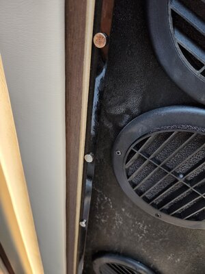

Here are some picks for the front panel (other 2 similar) after the previous attempts to remove all the dislodged magnets from the metal on the ceiling and trying to reglue them into the wooden panel pockets. The glue sat for a week before putting the panels back in place in the ceiling.
1st photo is a hanging panel after enough magnets came unglued, 2nd photo shows the 9 magnets that came out of the wooden panel pockets and stayed stuck to the ceiling bracket (the silver dots), 3rd is a close-up of a couple of the the empty magnet pockets where the pocket/glue gave way.
I think perhaps Newmar didn't think this magnetic panel attachment idea through all the way.

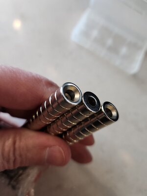

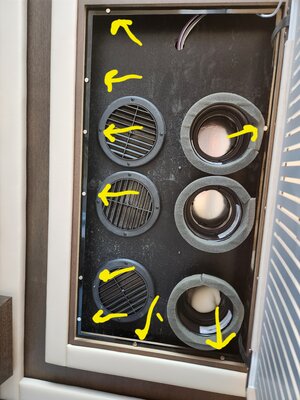

So, when you think magnetic the first thing that comes to mind is metal! Well at least that is what comes into mine!
It is great that they didn't finish what was behind the vent. At least that is what I'm thinking!
The answer in my book, is to get the multi tool out and slot from the side of the frame, under the bore for the magnetic!
Then slip a washer or piece of sheet metal in the slot. If you want glue the magnets to that and you will have increased the holding power considerably.

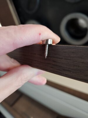

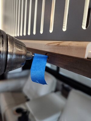

I am not sure CA is however could you make small metal plates the size of the magnets and mount them with a countersunk screw where the magnets mount in the wood? Being that you have the wood shop you could use the router to add a little depth to where the magnets currently mount or make new pieces. I love my wood shop. It comes in handy with the coach work.
