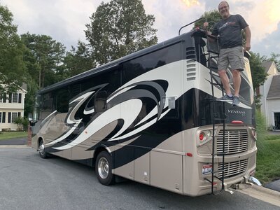

I just finished repairing the bottom pin lock on the Ladder of our 2015 Ventana LE. While I was there I checked all of the screws/bolts on the ladder. Almost every screw/bolt was loose. Might be a good ides for everyone to check their ladders.
As for the repair. The bottom two screws had stripped so I glued/inserted a wooden dowel rod into the hole. With putty tape it all went back together and seems to be holding fine.
