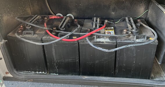

Hi everyone,
I’m new to the forum. Just bought a pre owned 2009 Mini Vista Cruiser about a month ago. So far been enjoying overnight trips with it here in San Jose California.
I’m going to load test the house batteries. They only last about 6 hours with just house lights and occasional use of water pumps.
1) Do I need to disconnect the batteries individually to do the load test on each of them?

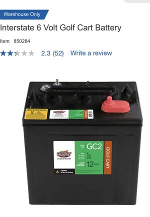

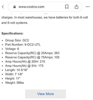

2) The load tester I’m using from Amazon will ask me to enter the CCA for the battery. I can’t seem to find the CCA written on the battery. I attached photos of battery and specs.
3) What’s the amp/hr capacity on these batteries? There a 2 ratings for amp/hr and 2 ratings for Reserve Capacity. I don’t fully understand them.
I’m somewhat of a DIY guy but new to RVs. More than happy to read up on technical reads on batteries. Thank you in advance for any advice on these questions. I’m new to all these
