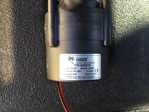

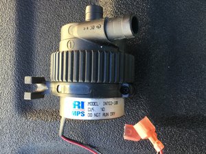

Here is picture of the old and new pumps. First is the old pump by GRI with the second is new pump by ITR, which was purchased April 2019
Thanks, Bill. That is very helpful. Gotta get out the credit card and stock up. I'm gonna buy two on the theory that if I have that many on hand, I will never need to use either one. Well, one can hope.

Here is my new pump just arrived with the invoice.
