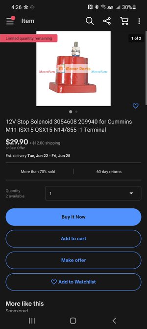

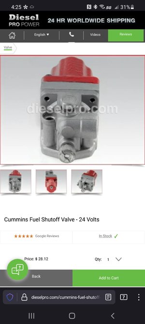

Here is a couple of options. I am leaning towards the 12v version, although they look the same.
This should all be under warranty AFAIK. If not, I’ll drag out the checkbook.

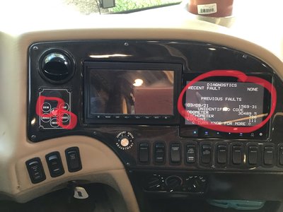

Are you talking about the “RV-C diagnostic codes?” If so, it says “No Faults” but I still have a Check Engine light showing.
TJ
No. The console display to the right of driver. See attached picture which shows an old fault when I had my DEF head replaced. If you press the view button to bring up the display and then the chassis button will cycle through a few screens, one which has chassis fault codes.
