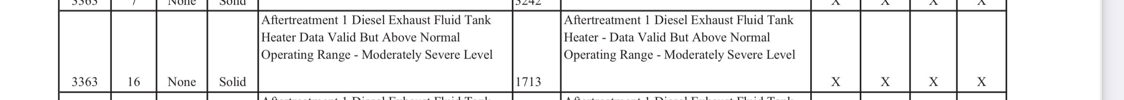

Thanks guy's! I can't do much of anything until I get the coach back from Freightliner. NIRVC was unable to determine what was causing the previously mentioned SPN 3363 FMI 16 code, and suggested it may be something that won't happen again. But that wasn't the case, and it reared its ugly head as we entered Florida. So now Freightliner can take a stab at it. Hopefully I'll have it back to get to Key West on time.
My rig's been sitting at Ocala Freightliner for the last two days. Wow, what an experience. The girl who answers the phone and also works the front desk, has apparently been to Freightliner school and excels in doing everything possible to be unhelpful.
My coach needed a DEF heating unit, about $1,000 at a dozen other places, but Ocala Freightliner is charging me $1,920.44. Then to install this friggen piece of gold, I have to pay another $1,125.00. Not sure, but I don't think there are more than a handful of bolts to remove/replace, a few hoses to clamp, and then clear the code.
So total out the door cost of doing business with Ocala Freightliner will be $4,147.95. I understand everyone has to make a profit, but this is crap.
What was the reason you took it there? Are they an OASIS branded FL location (meaning RV service center)? I hope it's not a misdiagnosis and you called 800-FTL-HELP for their guidance.
For that price difference I would be considering driving it to a different location to save the extra $1.5k-$2.0k
